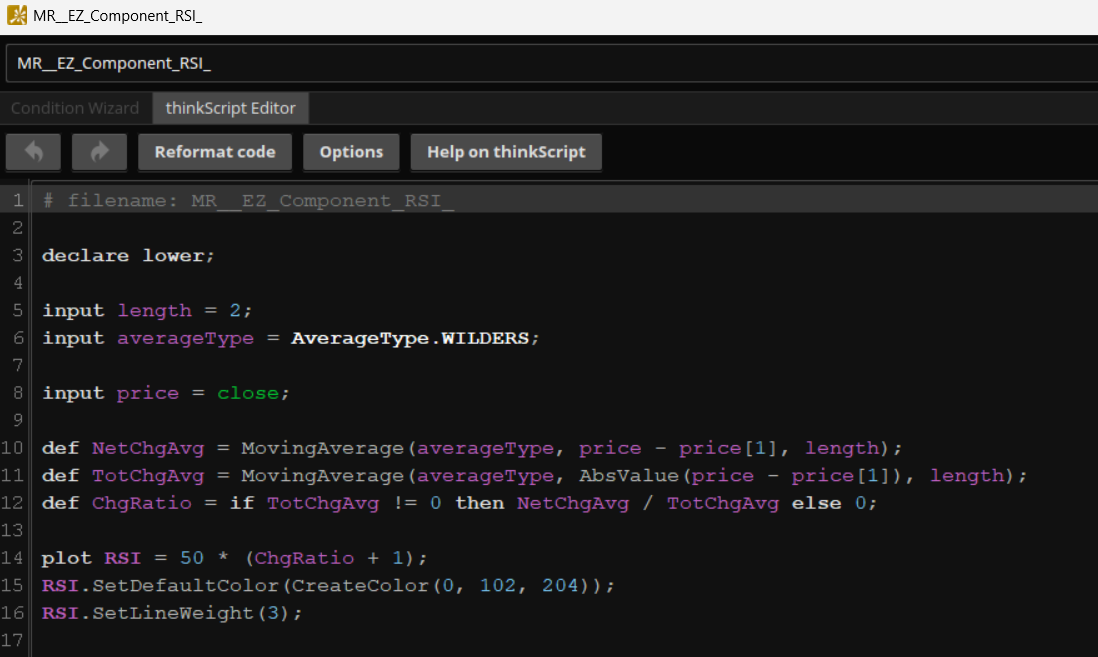

Post12:17 - Mar 29#3
Thank you for the swift reply.
I am chagrined to read that the thinkscript.uew I previously attached is not an UE syntax highlighting wordfile, for that is all I have. As for a thinkscript code block, below is a sample for your review and a screenshot of what the script looks like in the Thinkorswim Thinkscript editor:
declare lower;
input length = 2;
input averageType = AverageType.WILDERS;
input price = close;
def NetChgAvg = MovingAverage(averageType, price - price[1], length);
def TotChgAvg = MovingAverage(averageType, AbsValue(price - price[1]), length);
def ChgRatio = if TotChgAvg != 0 then NetChgAvg / TotChgAvg else 0;
plot RSI = 50 * (ChgRatio + 1);
RSI.SetDefaultColor(CreateColor(0, 102, 204));
RSI.SetLineWeight(3);
I hope this helps to illustrate what I'm hoping to achieve.
